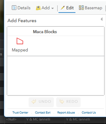

BlakeMorrison
I think my reason for needing the Classic Templates Managment, atleast in this scenario, has been solved. That was my bad. I refollowed a workflow and got things to work via Field Maps Designer.
But for what it's worth, I'm still unable to access Template Management in Map Viewer Classic. It appears to be the same issue as this post: https://community.esri.com/t5/arcgis-online-questions/was-quot-manager-quot-button-for-field-maps-in...
I can confirm I am the owner of the item, it is a hosted feature layer (I've tried multiple maps and multiple items), and it is editable.
Screenshot attached:
DebapriyaPaul
Thanks for sharing the screen capture, @BlakeMorrison. That is odd.
  • How was the Feature layer (in the screen capture) published?
  • Did you notice this behavior recently?
  • Is any other member in your ArcGIS Online organization experiencing the same issue?
  • From your response, I understand that the behavior is not specific to any specific item, but you can reproduce it with any editable feature layer that you own?
  • What editing permissions are set on the layer? Could you share a screen capture of the item details page > Settings > scroll down to Feature layer (hosted)?

DebapriyaPaul
Thank you for sharing the screen capture.
I ran a test with a hosted feature layer (with identical editing permissions). I can confirm that I see the Manage option in Map Viewer Classic while editing the layer.
Would you mind emailing me a sample Feature layer URL to investigate the behavior? It could be a test service and does not have to be shared publicly. My email would be dpaul@esri.com
As a side note, in Map viewer, adding the capability to Create a template is in the roadmap. We are working towards achieving functional parity with Map Viewer Classic before it retires in Q1 2026.

BlakeMorrison
Ok, so this is apparently a known bug. The potential confusion I'm having is that I'm looking for a template in a webmap, not in a FS. You can totally manage templates of FS in classic. You can no longer manage templates of a webmap. This is what has changed.
You may have been trying to communicate this. I can't tell.
DebapriyaPaul
Thanks for sharing your thoughts, @BlakeMorrison . In the February release this year, Map Viewer Classic has only been removed from new organizations, trials, and public accounts. This change has not impacted any existing organizations or user types specifically.
Map Viewer Classic Roadmap for Retirement: https://www.esri.com/arcgis-blog/products/arcgis-online/announcements/map-viewer-classic-roadmap-for...
We have identified the issue that's causing the Manage templates option not to display only when a Web map is opened in Map Viewer Classic. We are currently investigating the behavior.
Map Viewer Classic still supports configuring feature templates for a hosted feature layer by simply adding the editable feature layer (as the owner/Administrator) > Edit > Manage > Configure properties > Save changes to the layer.
Create feature templates in Map Viewer Classic: https://doc.arcgis.com/en/arcgis-online/manage-data/manage-feature-templates.htm#ESRI_SECTION1_AF343...
With Map Viewer Classic retiring in Q1 of 2026, I encourage you to try configuring templates in Map Viewer. We're actively enhancing the experience, with more improvements on the roadmap. Please share any key workflows you're currently using in Map Viewer Classic, we appreciate your feedback.
