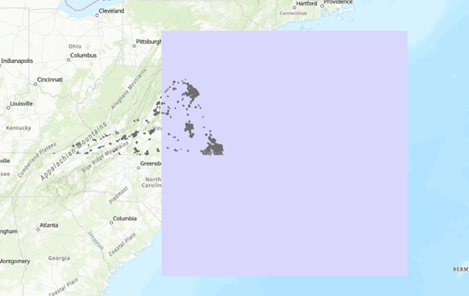

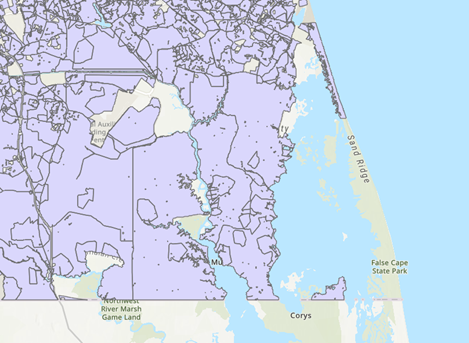

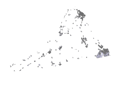

I am publishing to AGOL from Pro. The data shows up correct in Pro and in the thumbnail view of the published content. But when it's opened in map viewer - it adds a giant polygon. The polygon goes away if I zoom in. I've tried publishing in a new project with new data and the same thing happened.
How it looks in Pro:
How it looks in AGOL:
Zooming in resolves it:

Sounds like it is just lagging or something. Have you cleared all browser cache?
RhettZufelt
MVP Notable Contributor
Sometimes geometry errors in the featureclass can produce this.  You could try the check/repair geometry tool in Pro on a copy, publish and see if the issue goes away?
