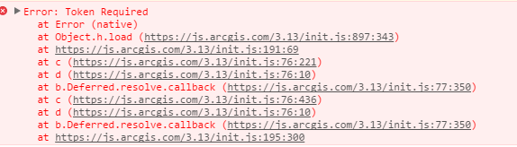

I'm wondering if this is relevant - In the browser (Chrome) console, I see:
Any ideas how I might troubleshoot this? The proxy log seems to indicate that it's having success but nonetheless something is obviously mis-configured somewhere...
