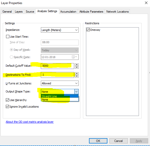

If you do not need the shape of the specific route, then I would recommend using the Origin-Destination tool. It will provide an O-D table with both Drivetime and Length.
BUT: If you did have Network Analyst, then other ways to address the problem could include implementing a Cut-off distance in the analysis settings to drastically reduce the problem that needs to be solved. That might do the trick in itself.
Alternatively you could apply fairly big Service Areas to all Facilities (without overlapping buffers), then use a Spatial Join from your Service Areas towards your incidents. Now you have established the closest facility for every incident. The final step then is to iterate (Python) specific routes, between pairs of Incidents and Facilities.
But the OD-Matrice is my best bet. It is quite fast because is doesn't need to write the shape of every route.

But in ArcMap you would have the below settings (and It's fast):
