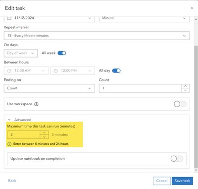

Hi @DrewDowling,
When scheduling or editing a notebook task, you can set the maximum time the task can run from 5 minutes to 24 hours. The setting is in Step 2, "set task schedule details" > Advanced.
I hope this helps!

Hi @DrewDowling,
I hope this helps!
