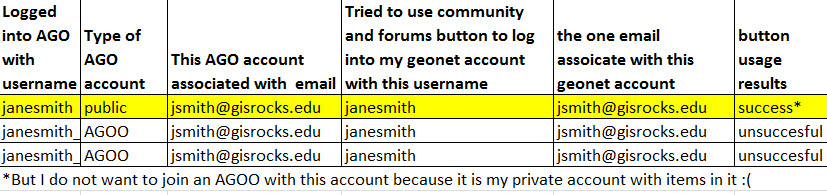

Basically the org users have to be logged into AGO/AGOO and geonet with the same username and email for the community and forums button to work. The only way I have found for the button to work with a different username is if I log into geonet first.
I did some experimenting and this was the result (when I was not prelogged into geonet).
