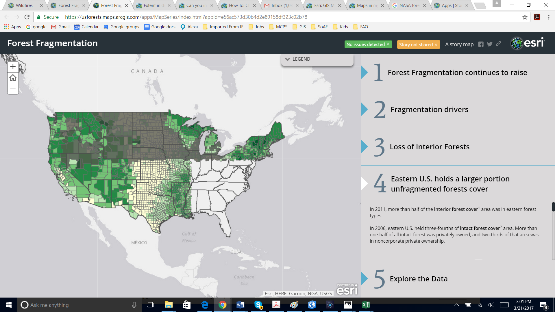

Kelly, thank you for the information. I have a similar problem that I cannot solve by trying your advise. As I am creating a story map, the map I want to show does not fully upload (the south east corner of the US is blank for a long while, si the screen shot). I have simplified the map as much as possible to just keep the info I want to show. The map is also published (not public yet) in my ESRI Online account and I have no trouble open it there (only when I try to upload it in the story map). Any advice? What is the size limit for interactive maps to open fast and completely in a story map?
Thank you in advance for your support!
Mila

Hi Mila,
It looks like there is a log of data in this map. When you open the webmap does a little exclamation mark warning appear in the lower left hand corner? If so, it may indicate that there are too many features to retrieve from the server.
Will this data be update frequently or is it static? If it's static, try using a tiled map service instead. This won't require the server to return complex geometry with each request.
If the data will be updating and you want it to stay as a feature service, try enabling optimized layer drawing. This simplifies the generalizes the data at small scales, leaving the complex geometry  when you zoom in closely.
-Kelly
