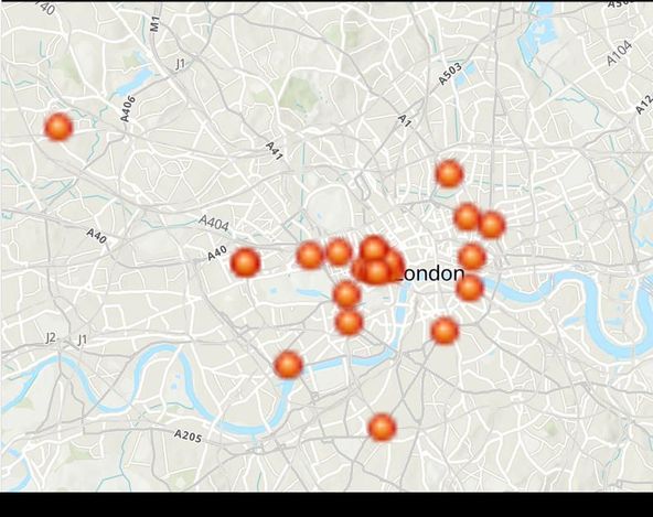

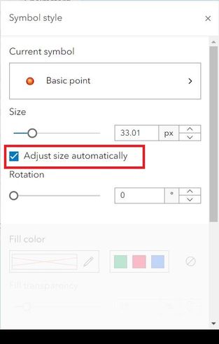

I tried this with a point layer representing Peruvian restaurants in London, by enabling the Adjust size automatically checkbox, and I got points with fixed sizes:

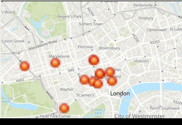

As I zoom in, the point symbols remain at the almost the same size:
Is this what you were looking for?
Hope this helps.
