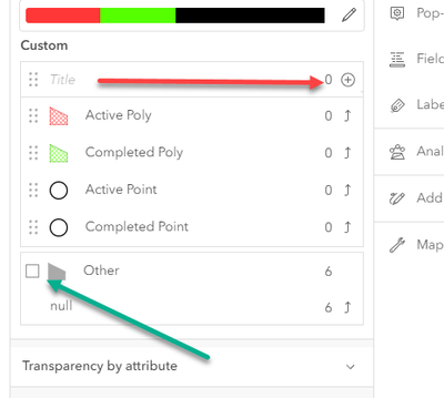

Not quite sure what you are asking,  but using Arcade to modify symbology has some issues (at least with unique values), so I'm going to guess that yours is related to this:
Seems Arcade symbology with unique values will only populate the symbolgy with values that currently exist when the symbology is applied, and sometimes not even that.
What happens if you turn on "Other" (green arrow)?  If that shows the missing symbols, then probably just need to set up the symbology for ALL  the other return values as well ("Both", "Eurasian watermilfoil", etc.).
If the "Other" options show the missing values, then you will want to "Add" the other values to the list.
Another method that is sometimes easier is to add all possible combinations of the return data (symbol values) to features in the dataset.  Then, when you apply the symbology from Arcade, they will all get populated, then just delete the "temp" features from the feature class.
