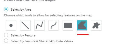

I am using ArcGIS Web AppBuilder. The intent is for the managers to use this web app on their desktop to QC that day's work (as opposed to mobile). I have the web app all linked up to my web map where the data is stored. I go to Widgets, select Batch Attribute Editor. I Select 'Select by Area', Polyline. Under 'Define Layer(s) to Update', I select my Points layer. Under 'Define Field(s) to Update, I select the field they'll need to be updating regularly. I hit 'okay'.  I hit save on my Web App, hit launch and begin testing to make sure it works as expected.
Testing: I zoom into my area I'd like to update, click and open widget. Select Polyline. Draw polyline, double click to finish. Nothing selects. While gathering screenshots for this post, it actually managed to select 3 records, which it has never done before. There's going to be several hundred if not 1,000 points. I've tried selecting one at a time, groups of 5, the whole area and it will not make the selection.

Why are you only allowing selection by Polyline? Can you allow for selection by Extent, Polygon, or Freehand Polygon? It's much easier to make a selection with those tools. I just ran a test on my Batch Editing tool with the Polyline selection tool and it wouldn't select all the points that I tried to draw the line over. The level of precision required to select a point by Polyline may be just too high
KWilliams
Polyline is just as simple as polygon in my opinion. Extent would cause issues due to the way the data is laid out. On Friday during my testing none of the selection features were working at all. This morning I did try polygon and that appears to have worked just now.

Hi @KWilliams , yes I believe for your case Select by Polygon should work best. It allows you to draw a more precise area for selection.
