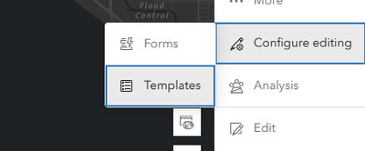

I can't get the "Manager" button, under Edit  in Map Viewer Classic to show up on my hosted feature layer, so that I can add a field template. It worked fine a couple weeks back. I also cannot add a new value to the field template in Field Maps Designer. All it lets me do is clone the template, the value box is greyed out. Any help would be appreciated. Thanks!

I contacted technical support and the best solution was to just rebuild and manage the feature template and domains in ArcGIS Pro. Hopefully this functionality is implemented in the newer Map Viewer soon.
EmilyGeo
We've added support for managing templates in Map Viewer. Check out this article for more information on how to get started: https://www.esri.com/arcgis-blog/products/arcgis-online/data-management/optimize-editing-with-templa...

One work around for now is to open the layer in Map Viewer Classic from the item details page. The Manage button should appear in the new map. Please give that a try.
As for values being greyed out in Field Maps Designer, I've not heard that before. That could be a separate issue.
