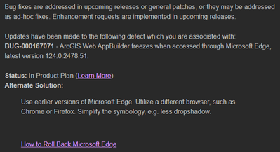

Status update on the bug case BUG-000167071 from Esri Inc. Hopefully patched soon!
