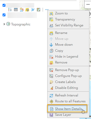

Hey @PeteFellows, are you talking about the equivalent of this option in Map Viewer classic?

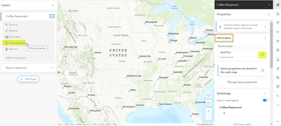

There is an information section in the layer properties. This would be the equivalent on Map Viewer. It launches the item details page.
The REST URL option would typically be accessed from the bottom of the item details page.
