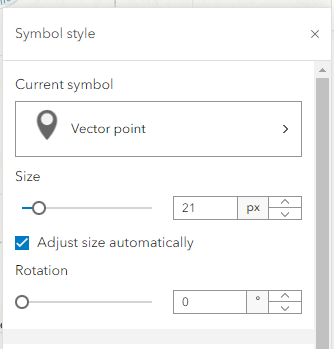

I am using vector symbols in a map, and I have checked "Adjust size automatically" when setting the symbol style properties in Map Viewer. The symbols resize nicely in the map at different scales.

Is there a setting in the Legend widget for Experience Builder that would keep the vector symbols at a standard size within the legend?
