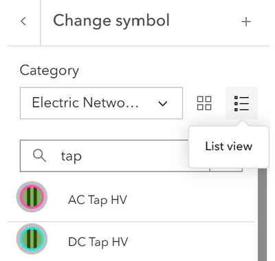

-JC-
Yes, this reply is years late, but there is an easy in-editor solution, so for anyone with this same question...
You can see the names associated with each symbol by switching from Grid View to List View.
Switching to List View also allows you to search for symbols by name.
