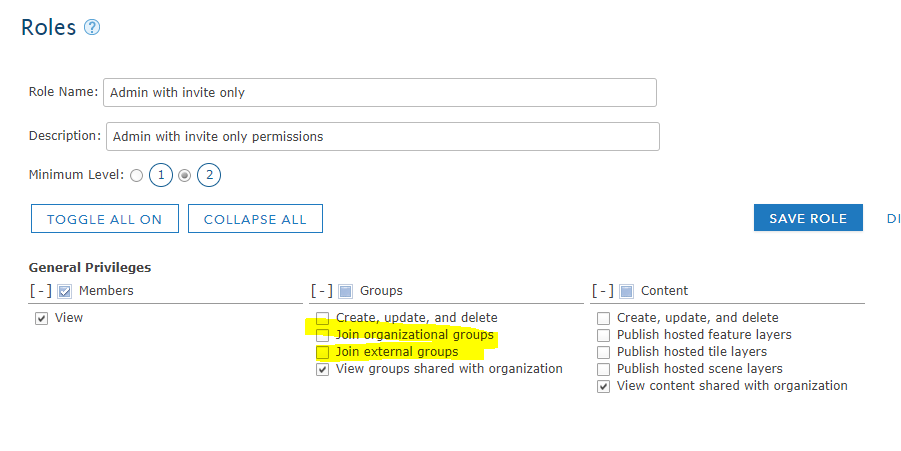

PaulLohr
I think there must be at least one more variable as to why a user cannot be seen. I can show you a case where two users have both their profiles set to 'organization' visibility (Who can see your profile?). One can be found, the other cannot.
MikeMinami
Esri Notable Contributor
You might want to check if the role of the user permits them to join groups.
SuzanneLevine
Thank you... that worked!
