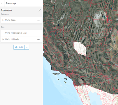

Can you move the layers you want to draw over the imagery layer into the Reference layer section of the basemap?
It would look like this
vg11
So this partially worked... as in my lines drew over the imagery, but I need the ability to toggle between world imagery and the plain white basemap. Since the water lines are reference layers in the basemap, when i tried to toggle, the lines and meters would disappear and only appear when the world imagery was enabled. Any way to get to keep the reference / basemap / tile layers visible (waterlines, meters and valves) and only toggle the world imagery and blank white background?
