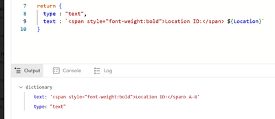

I tried to use the following that I saw in another post, but it kept thinking it was a dictionary and it made a table, with the bold tags displaying as text. Any ideas?
var Location = $feature.LOCATION;
var Description = $feature.DESCRIPTION;
var Facility_Status= Proper($feature.STATUS);
var Asset_Code = $feature.ASSET_CODE;
return {
  type : "text",
  text : `<b>Location ID:</b> ${Location}`

JennHat
Thanks! Turns out, I was putting it in the wrong spot-- I was using the Attribute Expressions instead of just adding Arcade code as content to the pop up. It worked once I did that. Thanks for providing options!
