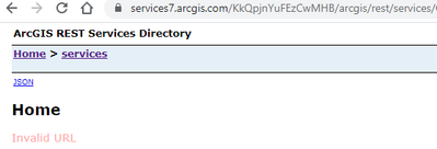

LaurynasGedminas2
What i mean, is that then i publish the FGDB with one polyline feature, publishing fails with "Error occurred" error, but content item is published, and the feature class has invalid url error
how to debug, fix this?
Thank you,
ManishPatel
Sorry for the delayed response, thank you for sharing the FGDB, I have tried to publish this and I am able to view the data, visualize on the map and view the Service URL as well.
Please see the link:
https://services1.arcgis.com/vHnIGBHHqDR6y0CR/arcgis/rest/services/GRMO_trails_WebMercator/FeatureSe...
When you published the FGDB, have you stored the FGDB in a folder and then zipped that and published it as a feature service, I have extracted the content and zipped the FGDB.gdb to zip which then I published as feature service.
Hope this helps.
Cheers,
Manish

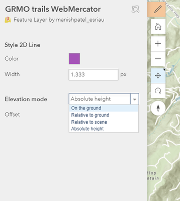

LaurynasGedminas2
Thank you, it is working.
How to make it show up on the top in the Scene Viewer?
right now its not visible
ManishPatel
Great to hear 🙂 and happy to help
Regarding the Scene Viewer, once you add the layer to the Scene, navigate to Layer style
Once in the Layer Style, set the Elevation mode to "On the ground"
This should make the layer visible on the map, you may further change the width, color properties.
Hope this helps.
Cheers,
Manish
