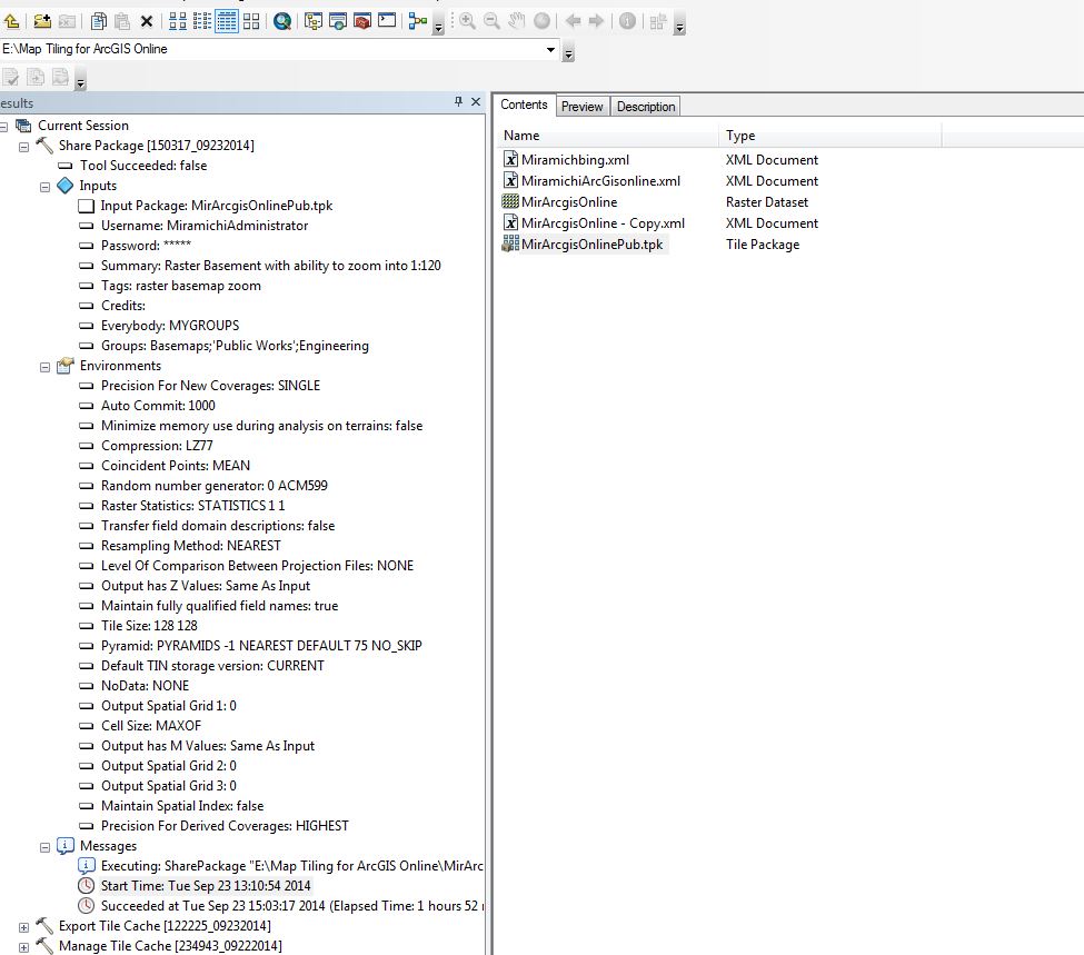

I created a tile package locally and uploaded it to ArcGIS online using the share geoprocessing tool.  I received no error messages.  However when I go look in My Contents it is not visible anywhere.
The package was very large at about 70GB and contained a Level of Detail down to 1:120 as the default basemap resolution is not close enough for our field guys to see infrastrure in a small area.
Strangely enough when I look at the geoprocessing results I see "Tool Succeeded: False" but no error messages.  See attached.Tile Package.JPG

Finally got it figured out, actually ESRI Tech did.  When running the Share Package geoprocessing tool there are two environmental settings under "workspace".
Current Workspace:  C:\Users\thomsonr\Documents\ArcGIS\Default.gdb
Scratch Workspace: C:\Users\thomsonr\Documents\ArcGIS\Default.gdb
Mine were pointed at my solid state drive C: which only had about 8GB free.  Obviously that was not enough.  Pointing to a separate hard drive with Terabytes of space solved the problem.
