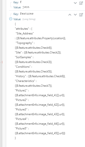

With Integromat I am trying to update a feature service (A), which is shared with my organization, with attributes of survey 123 feature service (B). I have a flow in Integromat, which is watching the survey, and when the survey is submitted or edited, it updates A with B's attributes.
This is  HTTP Request module (POST)

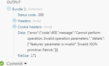

      This is my error:
There are couple of things that can cause the error:
1) I cannot match the services with Object ID, so I try to do it with "Site_Address" field, cause originally the forms for the Survey (B) are created from feature service (A) in Collector (by URL), and this field is pulled to the survey, so they 100% match. I think it's not working like this for http requests, I am not sure. Can I only edit the feature service with the same object ID, or I can use another field as unique identifier (in my case - "Site_Address"?
2) As soon as survey 123 form and destination layer are shared with the same group in organization, I thought it would be fine to use token from survey 123 to update feature service (A), but I am not sure.
3) Wrong syntax?
Could you please help me to figure this out?
Thank you!
