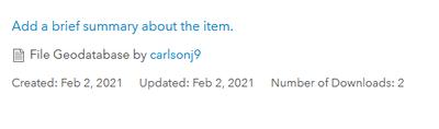

Good questions! When I tested this, my FGDB did get a new update timestamp, so that seems a bit odd.
