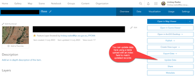

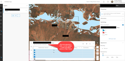

Can you provide more information? Based on the assumption that you are working in the ArcGIS Online Map Viewer, have the layer table open and have selected records that way - the short answer would be no.
There is no calculate attribute option that can be applied to records in Map Viewer. You would need to either use the Update data option through the layer item details page, or alternatively, through ArcGIS Pro.
