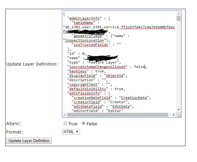

Specifically, I am trying to set the sourceSchemaChangesAllowed property to false (and eventually back to true). So in the admin page of my service URL, I go to update definition.

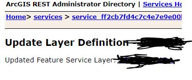

I change true to false in the above, and then replace the last edited field with empty double quotes. It returns the following page with no error:

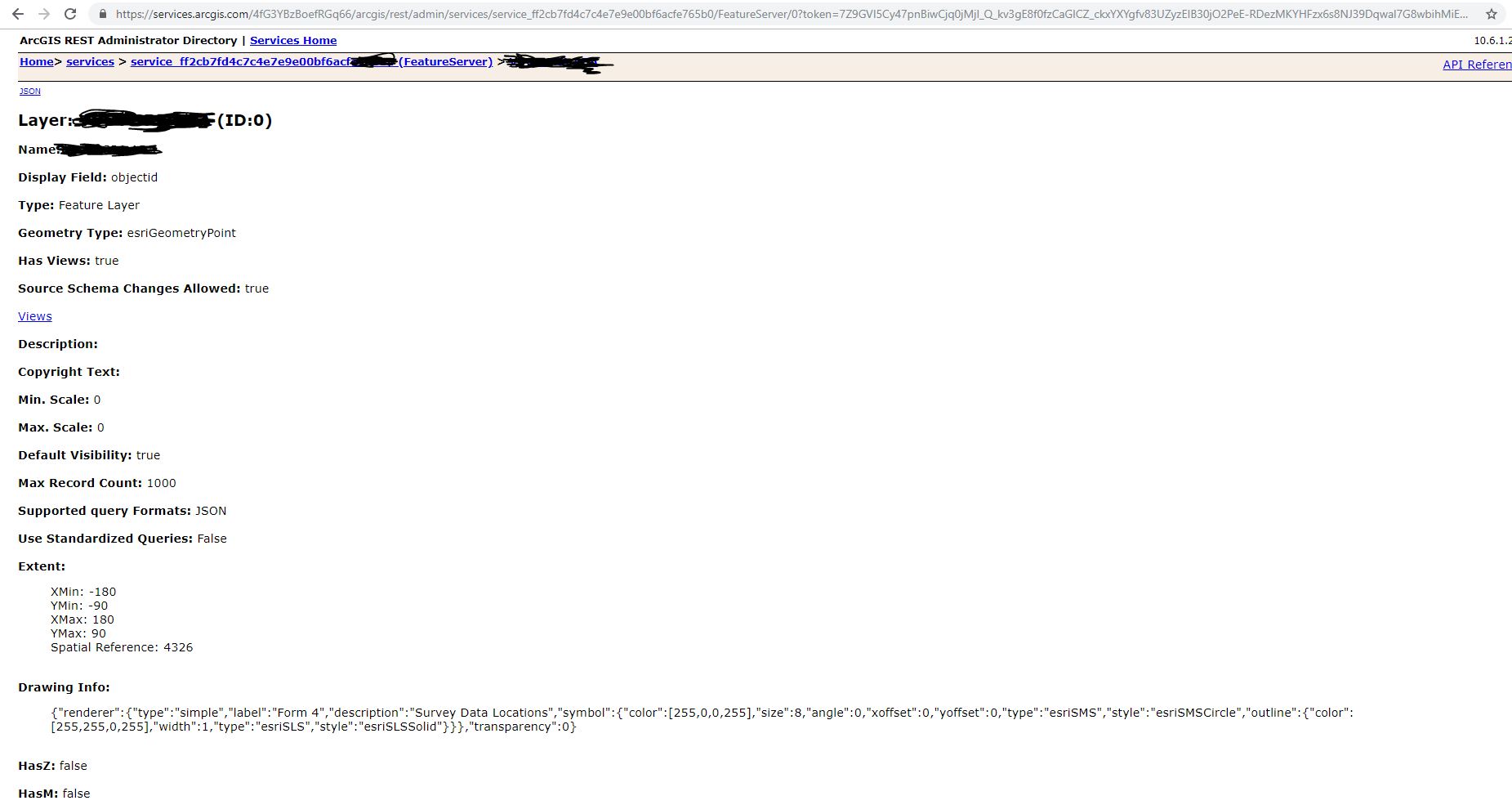

In addition to the path above, I also tried click back to my view feature server, like in the screenshot below of my test feature service. The change still updates as if it went through, but nothing is actually changed. This screenshot is after I changed sourceSchemaChangesAllowed to false.
