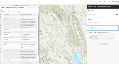

Hello,
Goal: I am mapping research projects at multiple nature preserves, and would like to be able to select a polygon (nature preserve) and have the titles of the projects appear in the pop-up.

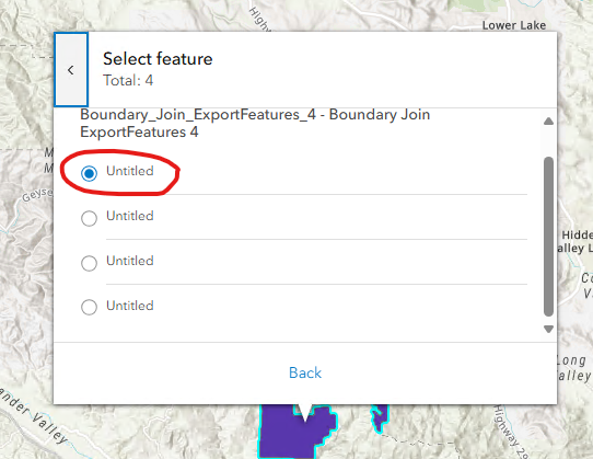

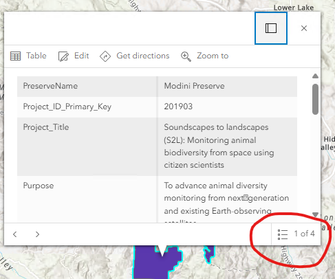

Issue: When I select the polygon in both ArcGIS Online and Experience Builder, the list of projects appear as "Untitled".
What I have tried so far: In ArcGIS Pro, I have selected the "Project Title" as the display field, and have configured the pop-ups to be the "Project Title". In ArcGIS Online, I have configured the pop-ups to have the "Project Title" as the "Title", but that only causes the project title to be on the pop-up that appears after I click on one of the "Untitled" projects. I have attached an image of the "Untitled" pop-up, and the result when I click on one of the "Untitled" projects.
Question: Do you know how I can get configure the pop-up for all the projects in a polygon to display the Project Title when I select the polygon?

That will show whatever you have set as the Title in the Popup configuration. Note that your popup doesn't have a title in the individual popup
EKandD
That also seems to be an issue. I have the expression set up to show the "project title : project ID", which looks correct when I have the pop-up configuration open. But when I click on the item after I close the pop-up configuration, it appears like my pictures in the original post.
Is there a step to save the pop-up title configuration that I am missing?
Thank you so much for the help.
EKandD
I completely logged out and then logged back in again and now it works. Thank you for the help!
