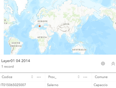

Hi guys,
I have a very weird problem: I can't manage to correctly upload a small Shapefile to My Content in the ArcGIS Online. I have already uploaded many shapefiles, but I don't understand what's the matter with this little one. We have an ArcGIS Server federated with an ArcGIS Portal so I normally host the features on the server, but when I upload the zipped shp, the process seems to complete correctly, but I can't visualize it in the Map viewer nor in the attribute table.
The problem is not the file, since I can import it just fine in the Map Viewer!
Do you know what I'm missing here???
Thanks

Hi @SalvatoreValente ,
I have conducted a test based on the sample data you have provided and I was able to successfully add the .zip to ArcGIS Online as a hosted feature layer (image below).
Does this align with what you are expecting to see?
Do you use Google Chrome? if so, it is worth checking to see that you are running the latest version. If you open ArcGIS Online through an alternative browser, do you experience the same issue?

SalvatoreValente
Hi Matthew! Thanks for your reply!
Yes, that's my shapefile and yes, I'm using Chrome which is updated to the latest version.
I tried with Microsoft Edge, but the result is exactly the same as in Chrome (see picture below).  I don't know how to fix this 😞
