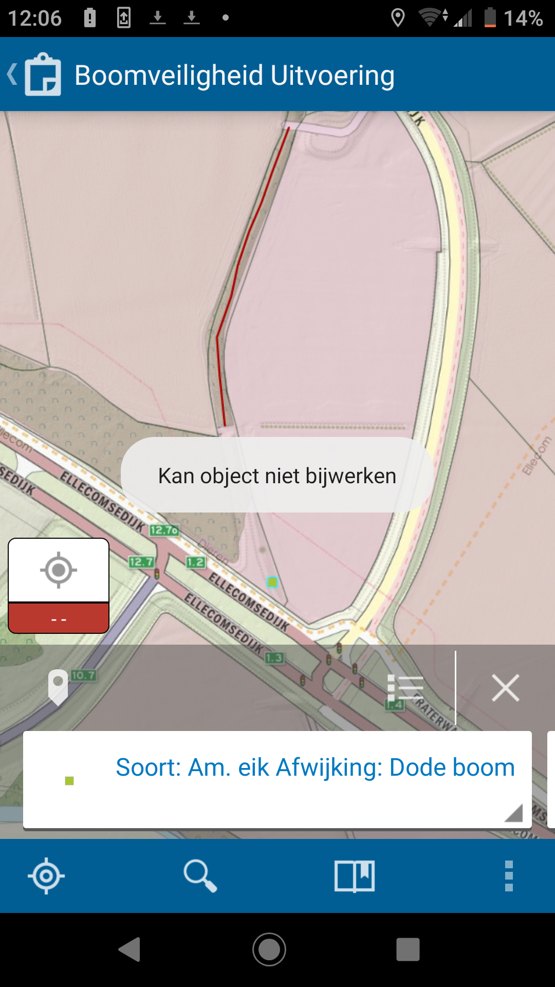

I've made a Web Map with 1 Feature Layer and 2 "Hosted View, Feature Layers". I've set up the map as such to visualize 1 Feature Layer in different ways in 1 map.
When I open the map in ArcGIS Collector on Android, Online, I can edit the layers and there is no problem. When I take the map offline it tells me I cannot update the feature.
Is it possible to edit Hosted View, Feature Layers offline? If so: what could I be doing wrong?

Hello Luba,
Thanks for your answer. While trying to answer your question I noticed I am able to update feature while using another basemap. So the basemap was causing the problem.
Now I just need to figure out how to get the symbology working.
Again, thanks!
GISTeam4
Hello Luba,
At first, as I stated in my previous comment, the problem was solved using another basemap. After reloading the map, however, the problem reoccured. I've tried the same map on a different device (Nokia) and the problem seems to be gone again. It's not a very consistent problem it seems. I'm hoping the problem was caused by the device and it won't occur for the field workers.
