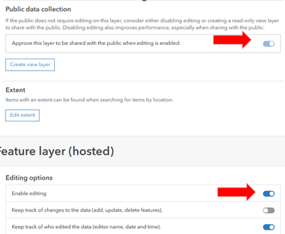

Can you take a look at the settings tab and see which of these is enabled?
ZenMasterZeke
Thanks @EmilyGeo . The public data collection tab was enabled, although I don't know how or why, and can't believe I missed that, but editing was not enabled

Any item that is shared with everyone (public) would not allow enabling editing, if it's not enabled to allow public data collection. This is to help avoid accidental edits and ensure that the data isn't corrupted or lost.  I am wondering if the item was enabled for editing at some point?
By design, disabling the capability to edit does not automatically disable public data collection by default. Even though we see the badge for the item, it would not allow us to edit the layer. The workflow to disable public data collection is outlined in the documentation here.
