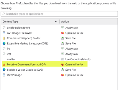

That could work - I haven't tested that behavior. If your ArcGIS Enterprise is public facing and the PDF is public anyway, you can just share the URL "by reference" instead of via collaboration, too.
I've noticed that Firefox gives me actions for how I want files to be used.
For me at least, Firefox downloads the file locally then opens the downloaded file. (eg: file:///C:/Users/user/Downloads/doc.pdf). That's cool and a lot less dangerous.
Chrome and Edge just download the file but don't open them. I haven't looked for an extension that will do it for those browsers. YMMV.
