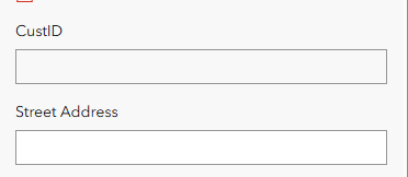

I have a super frustrating issue with a hosted feature layer and at this point am assuming that this is a bug in the Map Viewer Editor. I have a Web Map with a map service created specifically for testing purposes that contains a polygon layer and a table with a relationship class. The CustID field in the polygon layer is the foreign key and is also the field that needs to be populated when a new feature is created. This should not automatically disable editing for the field. When I add a new feature to the polygon layer  however, the CustID field in the Editor is disabled for editing, but I AM able to edit the field from the attribute table. This leads me to believe that the issue is with the form and not the layer settings.
In the Form config for the layer, the field shows up as Read-only and Editing is apparently disabled in the field settings:
The problem is that I am unsure of what field settings this message is referring to. The field settings in the layer details seems to indicate that the field is editable:

@FranklinAlexander, from this it seems like your relationship is a table -> feature relationship, is that right? If so, table to feature relationships aren't supported yet (feature to table and feature to feature are supported) in the form, so that'd explain what is causing you trouble

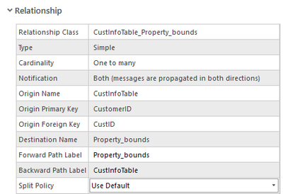

Hi @bbollin, thanks for the assist. Here is the relationship info:
The boundaries layer and the Customer table have GlobalIDs, but are not being used as a primary/foreign key, nor do I wish to do so. I did finally figure out that I could just select the 'Records' link for the record in the Customer Info table that I wish to relate to the new property boundary, then select 'Create record' in the Property boundaries panel that opens. This even autofills the CustID, so no need to manually input anything! There are scenarios, however, where a boundary is created when no customer record yet exists. I kind of solved this by creating a new customer record and leaving the rest of the form blank to be filled out at a later date. Now there is a new customer (at least a new CustID) that I can attach the new boundary to. I think this might be a good solution, but I am assisting other staff with this, so it will be up to them to decide if it works for their needs.
I am still a little confused about the CustID field being disabled, would like to know if this is a default behavior or if I am missing something. Could come up again down the road!
bbollin
FranklinAlexander
Yes, that is the direction of the relationship and I did it that way because I thought it made more sense. The Customer Info table contains unique records and the property boundary layer can contain many records for a customer. Having said that, the relationship seems to be working in the map viewer. The relationships are showing up in the tables and I am able to click on the related 'Records' link from the Customer Info table and see the related boundary records as well as create new and/or edit them for the selected Customer ID. For this workflow, the relationship is established between the selected Customer ID (record) and the new boundary feature. I will try and reverse the relationship and see if that makes any difference or adds any functionality. Eventually, we want to be able to copy features from a parcel database and paste them into the property boundaries layer when this functionality is available in the map viewer. If copy/paste is an available option from the workflow as described above, then there is no issue. If, however, it is not an available option it would be necessary to add the feature by editing the boundary layer directly (meaning no relationship will be established), therefore may be necessary to manually input the Customer ID for the new feature. In this scenario, the Customer ID field would need to be editable. 🙂
