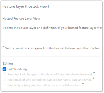

I am trying to create views for 9 layers. Even though enable editing is turned on, I am still unable to edit in the map viewer and in field maps. I am still able to edit the original layers just fine and I am able to view the REST API for all layers so I don't believe the layers are at all corrupted.
Is there any workarounds to this that doesn't involve republishing all 9 layers that are actively being used with sync enabled.

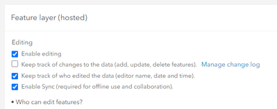

luckachi
Just did
Looks like they all say "Yes".
Paco
Did you Allow Editing when you first created the Feature Service?   Did you check the Editing box in the 'Settings' of your AGOL hosted layer?
luckachi
Source layer:
Yes, I believe I enabled editing right from the start. They layer was created back in 2020 so I honestly do not remember 100%

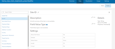

1. All of the layers that I would like to make views of allow edits. These layers are in a separate webmap for Field Maps and a Web AppBuilder application and they all work correctly, allowing edits.
2. I am unable to edit the view as a whole. When I add the view to my webmap, it gives me the icon on the right to edit because I am the owner, but it does not give me the Forms icon to set up the smart form for Field Maps. Also, when I go to the view's overview and click the data tab - right at the top it says Editing is disabled but you have privileges to edit this layer.

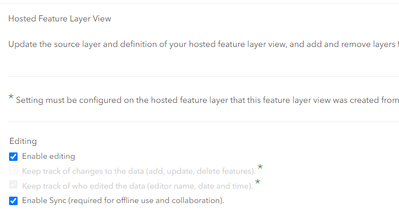

EmilyGeo
Hi @luckachi ,
Alix is right, technical support is the best resource. I apologize if you already spoke to this, I may have missed it in the the thread, but did you check that Editing is enabled in the Settings panel for each of the Views? I see that you said that Editing is enabled on the Source layer, but it needs to be enabled for each of the Views as well.
luckachi
@EmilyGeo - Yes, editing is enabled on the view layer. I reached out to one of our admins who will be able to create a support ticket for me, hopefully today.
