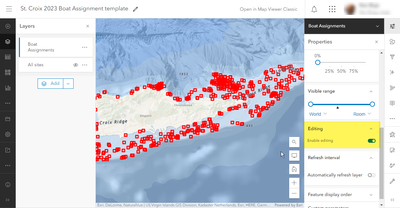

KenBuja
MVP Esteemed Contributor
Did you turn on "Enable editing" in the layer's Properties dialog in the map viewer?

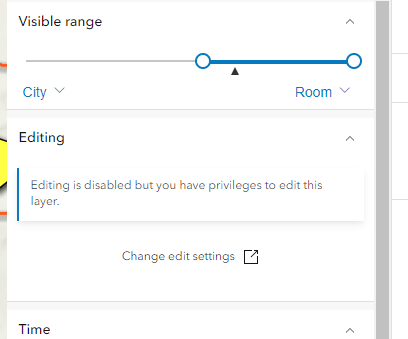

luckachi
@KenBuja
