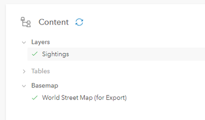

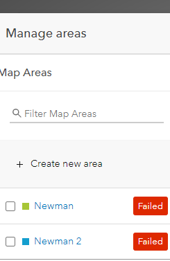

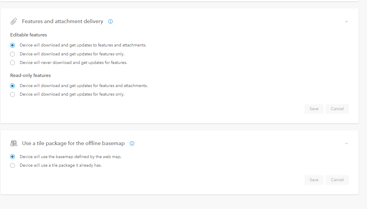

Hi, I'm using ArcGIS and have a feature layer and a web map set up in the UAT environment.
The feature layer is a registered dataset on SDE with sync enabled. However, when I attempt to create offline map areas, the operation fails and returns an error message. The exact error message from ArcGIS Server is not provided in your description.
here are my settings, which work with other maps
Thanks

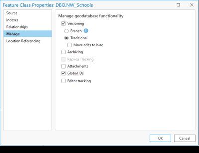

The following setting has worked for me in the past when using traditional versioning:
Enabling Archiving has also worked.
