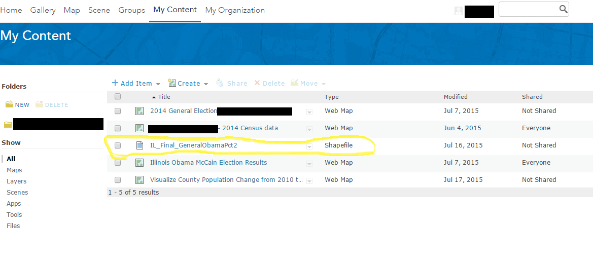

When creating a map, why can't I add a shapefile that's already a part of my organization's content?  Instead, I must "Add Layer from File" to add the shapefile.  I've tried sharing the shapefile with "Everyone" and/or my "Organization" but it does not show in the dialog below.
This screenshot was taken before setting the "Shared" status

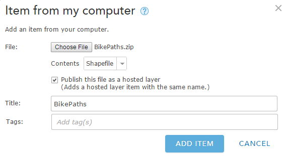

Hi Bruce,
You need to create a hosted feature layer from the shapefile, and then you can search for it.
When you add the shapefile to My Content, ensure "Publish this file as a hosted layer" is checked.  It will create both the shapefile and hosted feature layer in My Content.

Thanks Jennifer,

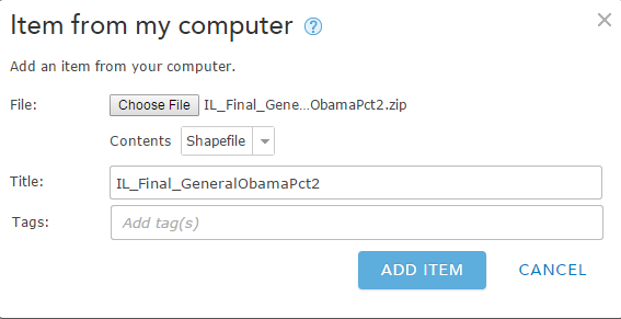

But that option is not available to me (see image below) - is it because the data is not hosted on our server, but ESRI's?
RussRoberts
Esri Notable Contributor
Your Organizational role might not have the ability to publish hosted feature services and that is why you cannot take your shapefile and publish it up as a hosted service.
