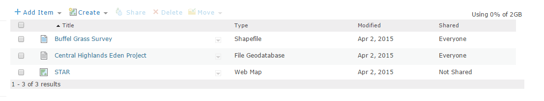

I have just uploaded a couple of project datasets to 'My Content' and then tried to add them to a map using ArcGIS Online but am not able to find them when searching for them and therefore not able to add them to the map.
One datasets is a shapefile and the other a file geodatabase.
I have shared them, added them to a group I created but nothing seems to work.

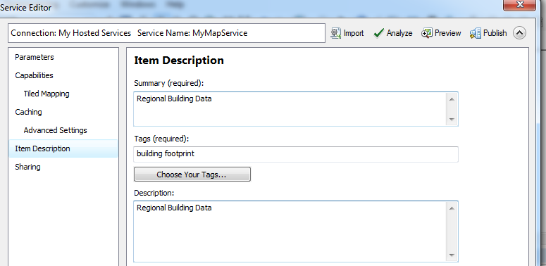

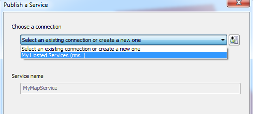

You could add the features as service to ArcGIS Online, using ArcMap.
Add the Shapefile/feature class to ArcMap. Define appropriate symbology and scale. Save the mxd.

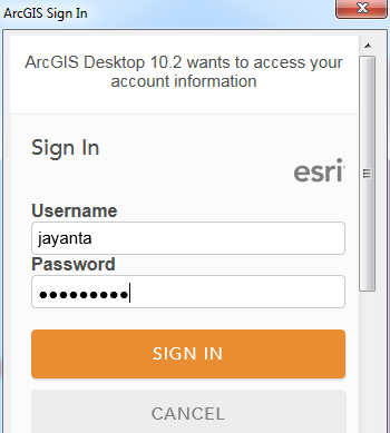

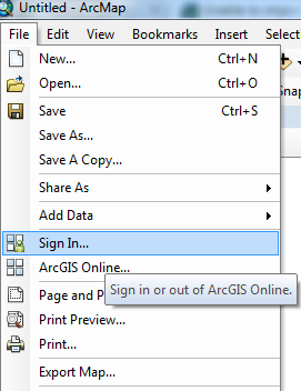

Go to File > Sign in...
Sign in to your ArcGIS Account

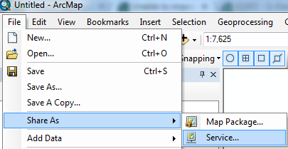

File > Share as > Service

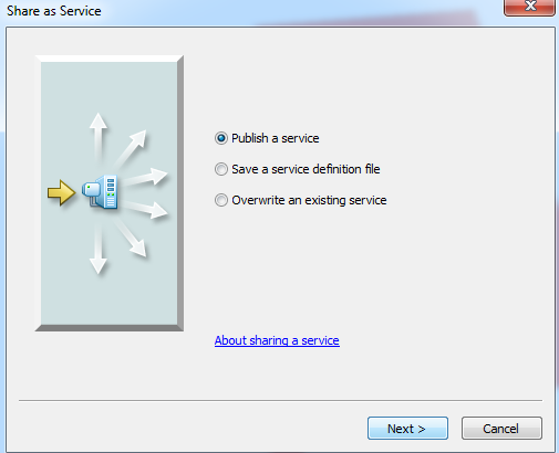

Choose "Publish a Service" radio-button. Next
Choose My_Hosted_Services. Give an appropriate Service name. Continue.

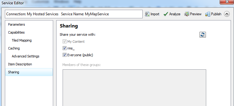

Service Editor dialog-box will come up. Choose item description in left-pane. Fill appropriate fields.
Choose Sharing. Share with appropriate group.
Click on Analyze. Make sure you resolve the errors , if any. Ignore the warnings and messages.
Click Preview.
Click Publish.
The data would be published on your ArcGIS Online. Try to open it on ArcGIS Online Map Viewer

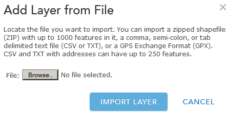

I guess, You cannot add the geodatabase feature classes on the map, even if you have added it to "My Content". The goal of adding the native GIS data formats is to share the data for download by the shared group.
You can add shapefile (zipped) with upto 1000 records on your Map.
Else, sharing the services would be the optimal option.

DeanHowell1
I added both a shapefile and file geodatabase to my content but can't even use them on my own map
