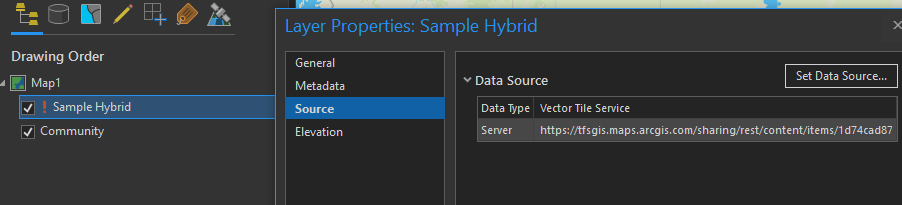

I created a custom base map to just hide the labels of the Hybrid Reference Layer in the Vector Tile Style Editor Portal and then saved it to AGOL. I shared the vector tile layer with a group for which I am the group owner/manager. Now when I log in to ArcGIS Pro and try to import the layer from the catalog, it shows a broken link like below.
When I navigate to the data source URL, it says that I do not have permission to access this resource.

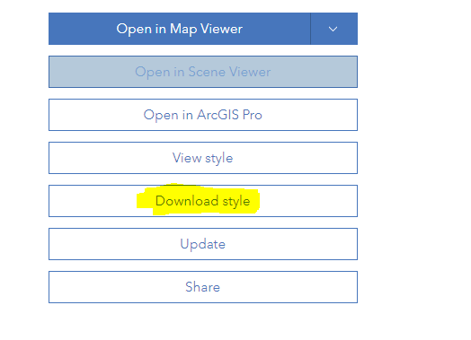

I also tried downloading the JSON style( root.json) and tried importing it in ArcGIS Pro. But it didn't even show that as an option to do. Is there something I am missing here?

Instead of trying to set the data source path,  try adding the "style" it will appear as a Vector Tile Layer when you search for it in ArcGIS Pro's catalog pane.  This article shows it..  /blogs/bock/2019/07/03/using-arcgis-pro-to-put-esri-vector-tile-basemaps-in-your-mobile-map
mark
RVG296
I did the same at first try. I added this vector tile layer.
