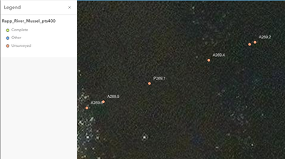

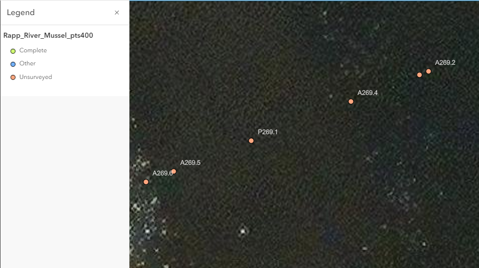

I'm trying to set up a map on AGOL for use in field maps that will have symbology based on two fields. The Status I would like to be different colors for Complete, Unsurveyed, and Other - as I currently have it:

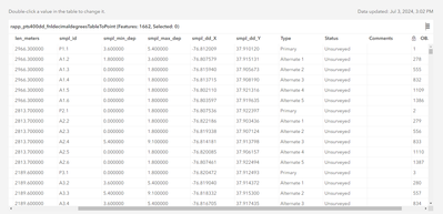

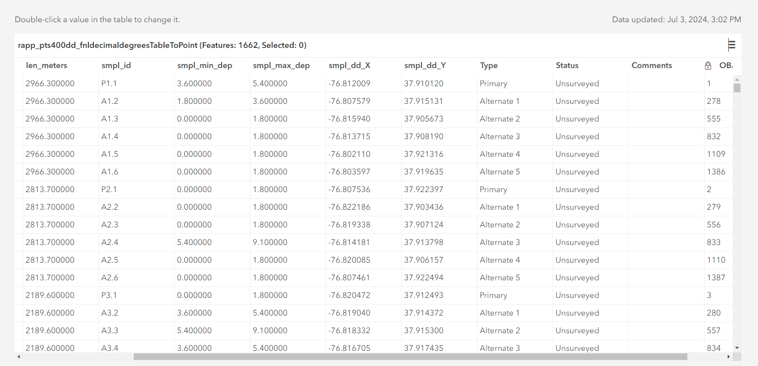

However, I would like the "Primary" Type points to have a different shape (star?) than the Alternates so the folks in the field can more easily differentiate that point from others (they will usually be conducting the survey at the Primary point, with the alternates as backups in case conditions are not good at the Primary)
