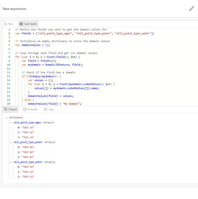

This is the expression that I have (written with the help of Microsoft Copilot).
All of these fields have domains but this returns null
// Define the fields you want to get the domain values for
var fields = ["util_point_type_ngas", "util_point_type_power", "util_point_type_water", "util_point_type_sswr", "util_point_type_strm", "util_point_type_telco"];
// Initialize an empty dictionary to store the domain values
var domainValues = {};
// Loop through each field and get its domain values
for (var i = 0; i < Count(fields); i++) {
    var field = fields[i];
    var mydomain = Domain($feature, field);
    // Check if the field has a domain
    if (!IsEmpty(mydomain)) {
        var values = [];
        for (var j = 0; j < Count(mydomain.codedValues); j++) {
            values[j] = mydomain.codedValues[j].name;
        domainValues[field] = values;
    } else {
        domainValues[field] = "No domain";
// Return the dictionary of domain values
return domainValues;

LandonHarris
The code executes fine but I get "No Domain" returned for all of the fields. I can confirm that all 6 fields do have coded domains. What am I missing here?
My ultimate goal is to return the domain values so that I can assign different styles for each coded value.

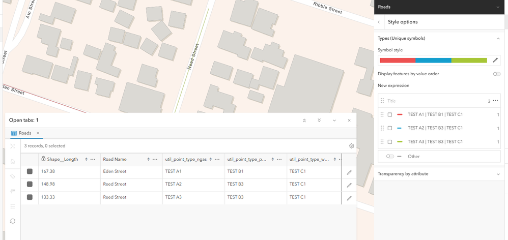

gis_KIWI4
MVP Regular Contributor
@LandonHarris - Like Ken said the code works but could you explain how you want use different fields to symbolize.
I don't believe the symbology profile supports arcade that returns a dictionary of arrays.
This might be a silly question but could you do with something like this?
Concatenate([DomainName($feature, "util_point_type_ngas"),DomainName($feature, "util_point_type_power"), DomainName($feature, "util_point_type_water")]," | ")
LandonHarris
I decided to solve the problem in the most simple way. I simplified what I was trying to do. I collected all of the coded values into 1 single field and now it works just fine.
