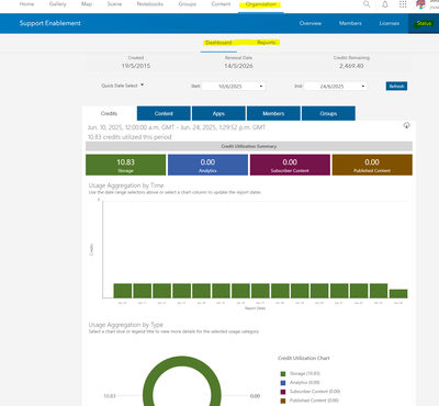

JonathanNowlan
Hi @MicheleInserra You can check this section in your AGOL account:
This will show you where the credit consumption came from.
