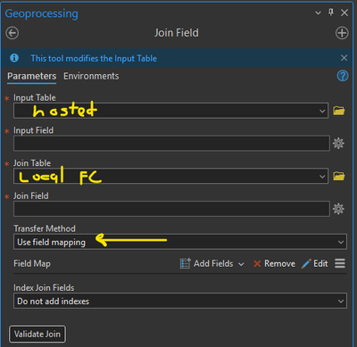

@TD1 , forgive me for what you may already know here. But here is a possible solution.
  • Run the spatial join to create the new output in a local file GDB.
  • add the hosted feature layer to a map with the new layer created from the spatial join.
  • Use the "Join Field" tool to "Add" the new fields with their values to the hosted feature layer
  • in the "Transfer Method" input, select "Use Field Mapping". This will allow you to only add the specified fields to your hosted layer
NOTE: This might not work great if you don't have a unique id column that isn't managed by the database. Sometimes GP tools have an option to preserve GlobalID in the Environment Settings but I don't see it on "Spatial Join". You can't use OBJECTID either because that will have been lost when you run the spatial join.
