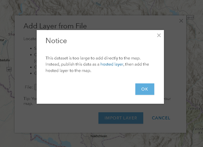

   I want to import my data in arcgis online. But i get this error. what can i do to import all data properly?

Hello,
Large datasets should be published as hosted feature layers to ArcGIS Online. This link documents the different types of data that can be uploaded. Please navigate to Content > My Content > New Item (see screenshot).
You will then be able to open the hosted feature layer in the Map Viewer. I hope this helps!

You will need to create a hosted feature layer with the source data: https://doc.arcgis.com/en/arcgis-online/manage-data/publish-features.htm
This will require the correct permissions to do this in your org: https://doc.arcgis.com/en/arcgis-online/administer/privileges-for-roles-orgs.htm
