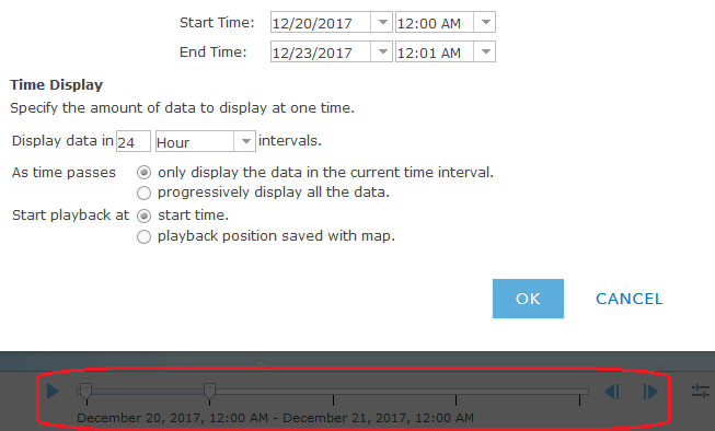

The web map was published and configured to allow time slider to show the feature layers with time.

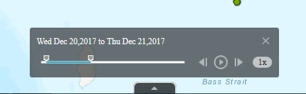

Then I created a web app using Web AppBuilder out of the web map with a TimeSlider widget added. The TimeSlider on the web app has three time steps while that for the web map has four steps as above. Missing the last time step stopped the last feature layer from appearing on the web app.
I thought the TimeSlider settings on a web app should match the settings on the underlying web map. Any idea?
