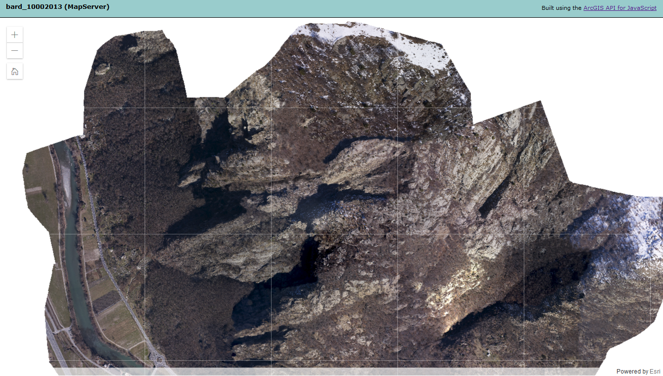

Tiles' borders got visible in my AGOL Tile Services

I found out that my Tile Services now show up with a thin whitish border around, so that it seems a grid overlays my tile layers (see image below). This does not seem to happen when consuming the service in a web map from AGOL, but it does from the ArcGIS Javascript Viewer (opened from REST), and when  consume the service in my app using the Javascript API (v.4).
Strangely, it not only happens with the new created tile services, but also with old ones that used to work without problems.
ChrisWhitmore
Hi Alessandro, this is a bug in the 4x JSAPI. Should be fixed with the next release (planned for Sept).
thanks,
Chris

PaulBarker
Assuming you're using windows, check your display scaling.  This happens to me when my display scaling isnt an even multiple of 100% e.g. 125% scaling shows it but 200% doesnt

PaulBarker
You can get into a similar situation with your browser zoom level too.  For example I can reproduce the gaps when I change the browser zoom level from 100 to 110 in chrome.  This is unlikely to be a server issue, and most likely a display scaling artifact.that gets introduced by the browser, the os or graphics card.
AlessandroValra
Thanks again for the quick feedback. This is very strange. Apparently, changing the zoom of the browser in Firefox does not fix the problem in my case. Also, zooming in and out in the different level of scales of my tile services the grid tends to disappear in some cases and in some areas, while being present in others. The same happens in IE, BUTnot in Chrome. Actually, in Chrome the artifacts are not present.
The only thing is that I really never noticed this before, and I could swear it never happened before my colleague noticed it yesterday. Now it seems all the maps I've created so far are full of these whiteish grid which looks awful. I will try to reccomend using Chrome if this is really necessary. As I said, this happens also in other computers, with different Windows versions and different hardware.

ChrisWhitmore
thanks,
Chris
AlessandroValra
Ok, thanks for the feedback. Will wait for September then. Thank you. Will come back to this thread to confirm it is fixed the next month.
