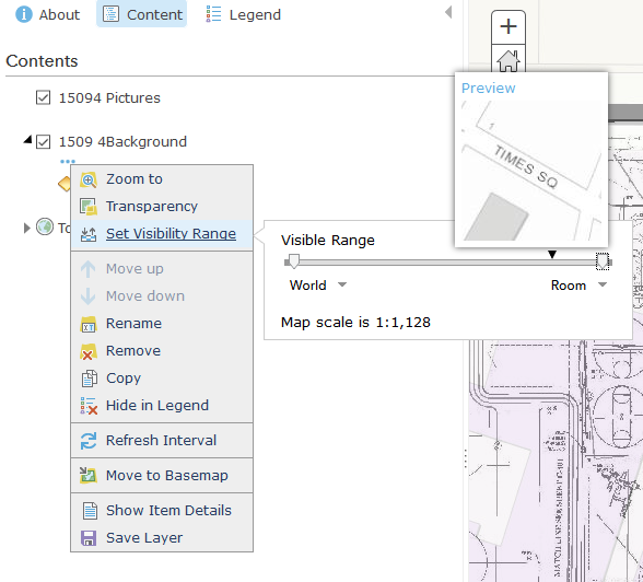

I have published a tiled image and I have set the visibility range to the max. However, it doesn't stay. Take a look:

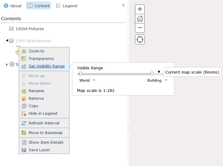

But, as soon as I set it, and zoom it, it changes back to its own preset default for no good reason. Is there any way around this? Is this a bug in ArcGIS Online?

From looking at the service authoring your web map, I'm seeing that your tile cache ends at Lvl 19 or 1:1,128. The Topographic basemap goes to 1:70 so the preset default shown in your second image reflects that your map service has no tiles to render below that zoom level.
Try adding cache levels below 1:1,128 and see if that fixes the behavior.
