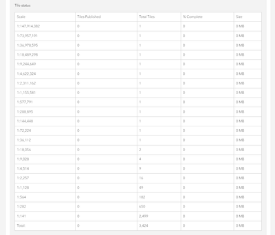

Following on from another recent post I have managed to upload a Tile Package into ArcOnline of some drone imagery from a TIF file
Upon getting this into AGOL and creating a hosted feature layer the imagery doesnt display in map viewer. I was doing some reading and came across this solution - Solved: ArcGIS Online: Tile Layer not displaying - Esri Community
But this doesnt seem to be working and when looking at the tile status it looks like this below, there is not ability to build tiles and it seems that none of them have been published? Does anyone know what is causing this? Maybe some configuration in ArcPro, im using TPKX

1. Import raster imagery into the ArcGIS Pro Catalogue pane.
2. Use the cppy raster tool to convert it to a Cloud Optimised GeoTIF (This step is optional, but I left it in as you had performed it)
3. Use the Manage Tile Cache tool to create a tile cache
4. Use the Export Tile Cache tool to export the tile cache as a Tile package
5. Go to ArcGIS online > Content > New Item. Add your tile package. Select hosted feature layer when you get to that option
6. Go to the Item Details page and open the hosted feature layer in Map Viewer.

We are experiencing the same problem. Any help on this from someone at ESRI would be very much appreciated!!

Sadly not no, i currently have an ticket open with and we are discussing how to resolve this, I will update this thread when I found out how

3.3. I don't think it is a Pro problem as it is also happening in MarMap 10.x as well 😞
GeomaticsPublisher
This works for you? We'll give it a go, thanks!
