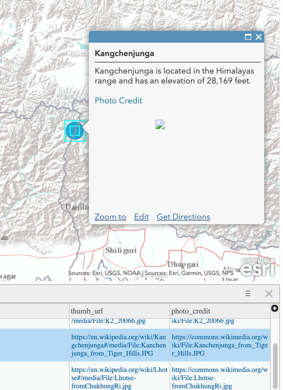

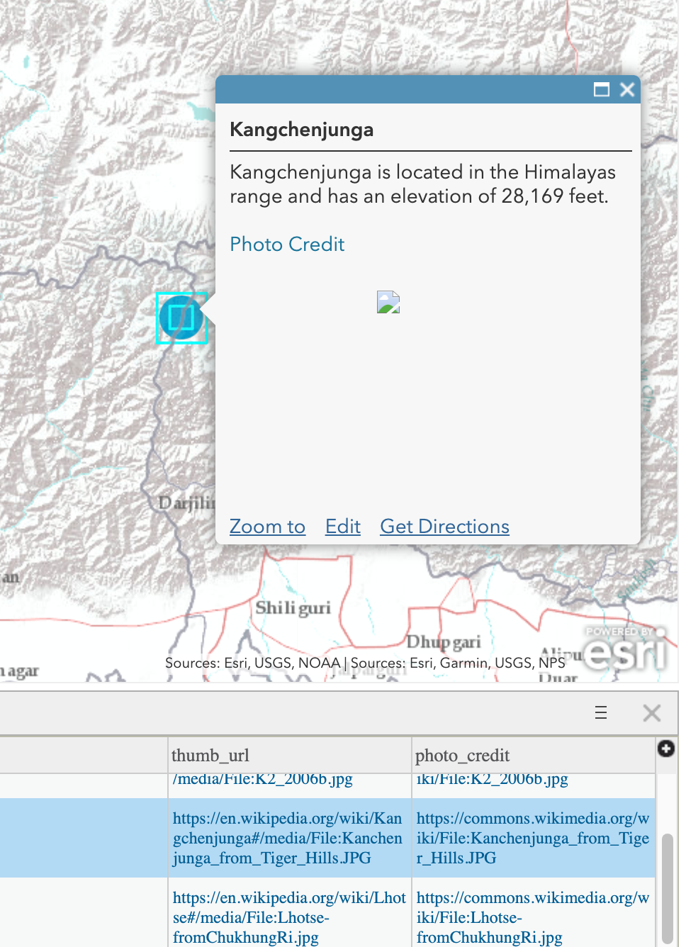

Hi, I'm trying to complete an assignment, "Climbing high Custom pop-ups", from ArcGIS Online "Teach with GIS" website.
I'm struggling to configure the pop-up information boxes to display a thumbnail image. Hmmm. I'm able to add a thumbnail icon, see below, but not the photo itself. Odd. Any help would be appreciated. -- Owen

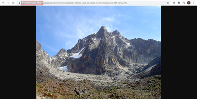

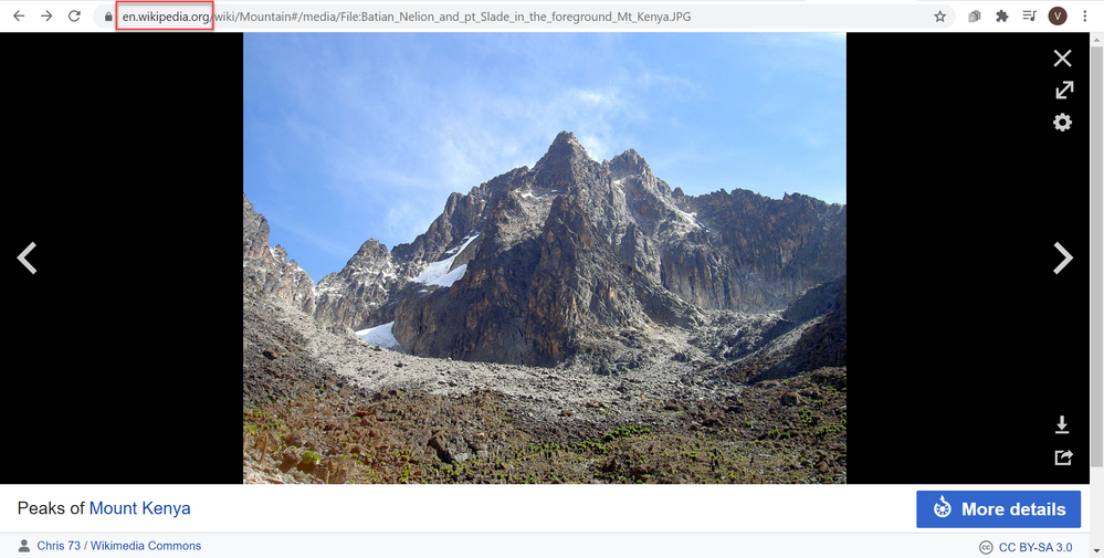

Thanks for posting on GeoNet! I got the same behavior as you when I tried to use the URL of pictures found on Wikipedia. Specifically, just from enlarging an image on the Wikipedia page and using the URL beginning with https://en.wikipedia.org or even https://commons.wikimedia.org
Rather, please try clicking on the image one more time so that the URL changes to https://upload.wikimedia.org and using this in your URL instead. The https://upload.wikimedia.org URL seems to be where the actual images are hosted. Changing this should allow the image to display as expected in ArcGIS Online.

Broadly, the https://en.wikipedia.org and https://commons.wikimedia.org URLs contain an internal redirect to the actual source of the image, which is uploaded at https://upload.wikimedia.org. Let me know if that makes sense, or if there's anything more I can clarify.
