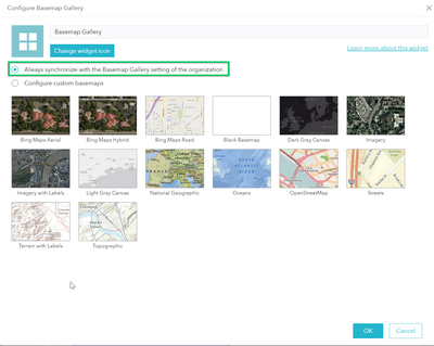

BillFox
MVP Notable Contributor
Did you try editing the widget in WAB and selecting the "Always..." option?
JenniferKuntz2
I am using Web AppBuilder developer edition v. 2.26 and I was having this same issue. I saw in my browser dev tools "404" (not found) errors for for images in <App folder on my server>/configs/BasemapGallery/. When I checked that folder, sure enough, the images were not present. I solved the problem by right-clicking Esri thumbnails and saving them with the same file names and location as listed in the browser developer tools. It was a bit of a pain but worth it if you'll be using the app a lot and don't want to use the setting that makes all basemaps in your AGOL organization visible (for some reason choosing that option doesn't cause the missing thumbnails).
