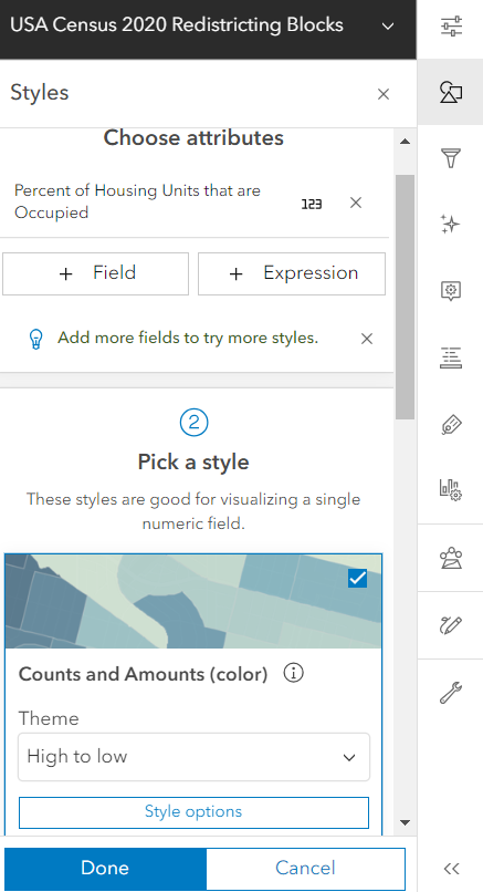

Have you tried using counts and amounts and then pointing it to your rate field? In the example below my rate field is % Housing Units Occupied. To further specify colors and ramp settings, click Style Options:
If you're still stuck, seeing a screenshot might help to further address your question.

It sounds like the field you want to symbolize on isn't yet a field, but provided you can calculate it using existing fields in your layer, you can do this directly in the web map symbology.
Click "+ Expression" at the top under "Choose Attributes". From there, you calculate the disability per capita which you can then symbolize on.
