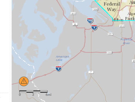

Hi ESRI Technical Support. One of my hosted feature layers in my AGO account is getting a warning error when I open it in a web map, as well as causing performance issues in my web map application.
When I hover my mouse over the yellow triangle it says "The layer, 2018 Voter Education Fund Grantees, did not draw completely."  Here are some facts about my dataset:

Hi Jonathan. Thanks for your reply. As luck would have it, you indirectly solved my problem. When I went into my feature layer's setting to disable editing to make it public and to post the URL for you, I noticed this section:
So far, after the optimization, my web map and web mapping application have been running smoothly.

I was having the same issue and went looking for ways to optimize the layer and found this which fixed my issue:
