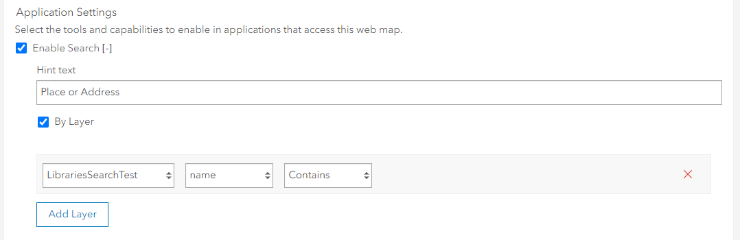

In the Web Map, you can configure searching as either a Contains search or an Equals search:

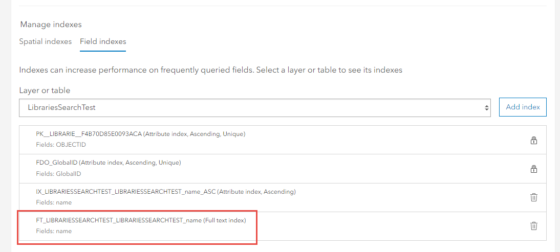

On the underlying 'LibrariesSearchTest' hosted feature layer the Full text index has been built for the 'name' attribute (this was created automatically):
The problem we have is that some words/characters seem to prevent the search function from working.  Some examples below of the terms entered in to the search box and the outcome when the map was configured to do a Contains search and an Equals search:

With a Contains search the main issue seems to be that certain words/characters/phrases aren't indexed as part of the Full text index (although I can't find anything in the docs) which means including words like 'the' or 'and' (or characters such as '&' or an apostrophe) in the search field stops the search function from returning anything.

This is just a test map and dataset so feel free to make changes.  You can see from the table in the original post the search terms we're trying to enable.  The map is currently configured to use the 'contains' search operation, the biggest problem with this configuration is when users enter certain words ('and', 'the', 'of' etc.) or characters (&, ', or single characters) these stop the search from returning any results.
